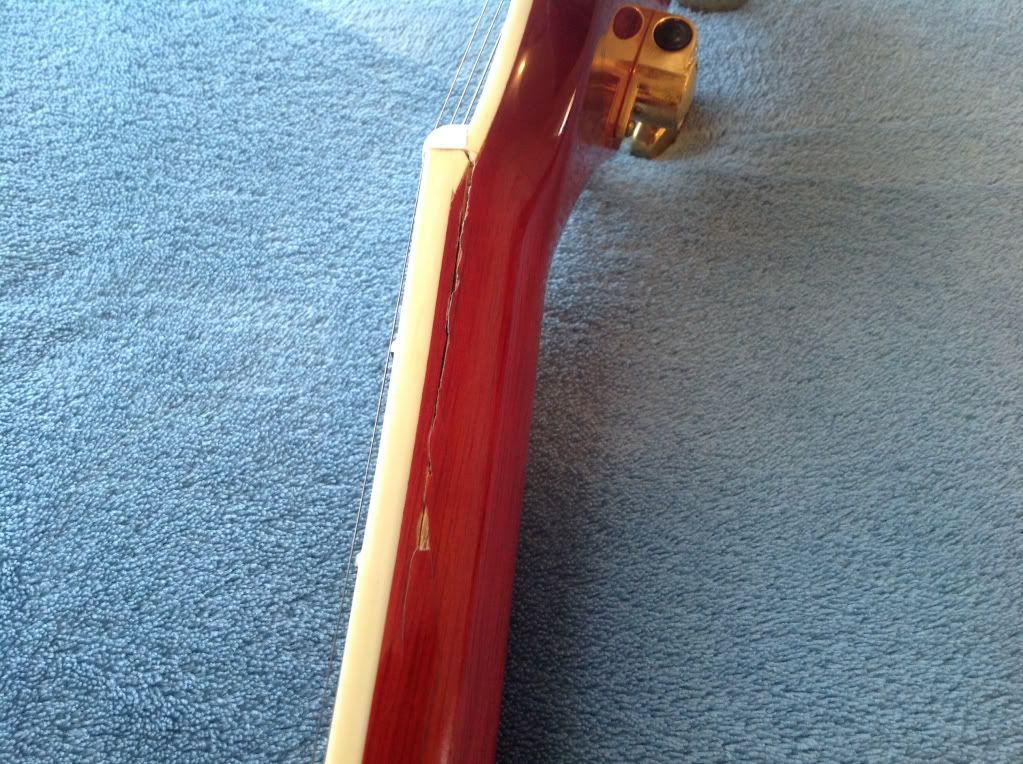

PostPosted: Sun Dec 23, 2012 5:30 pm Reply with quoteBack to top
I repaired this 2 weeks ago with Titebond and clamped it for a week. This was before the fix and with me holding the crack open. Keep in mind that this crack, as with yours, will be helped with string tension. Mine played fine and held tune even cracked, I just wanted it fixed.
