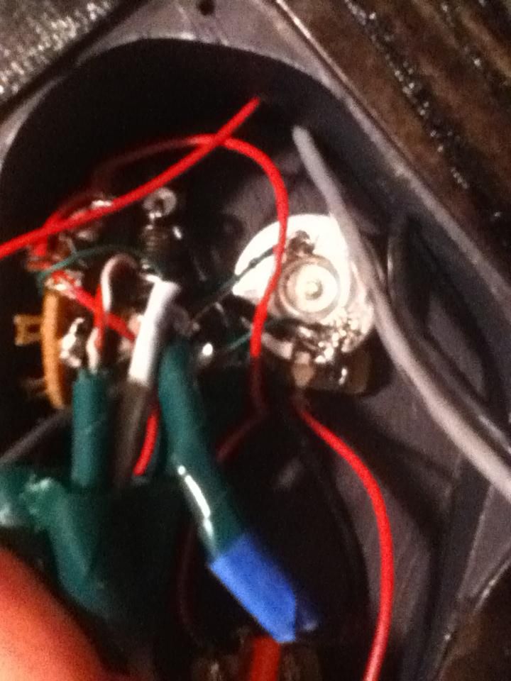

Here are the best pics I could get. Middle pickup is the grey wire, the black wire with the blue tape is the neck and the unmarked one is the bridge.

It is really hard to tell what you have going on there. Your wiring and your soldering is a mess. You definately need some soldering practice. And the photos are very unclear, so it is hard to tell what is what, and what you have each pickup routed to. but this is the wiring diagram for your setup. If it were me, i would pull it all apart, clean up the solder, and try to do it properly. Especially the switch and the grounds to the back of the pots. take a look at the diagram and make sure your switch is wired correctly.

That's the exact diagram I used, minus accounting for the trem claw ground and the face that my switch no matter which way you put it in, is not exactly like the diagram. The lugs are end on the right before they end on the left.
