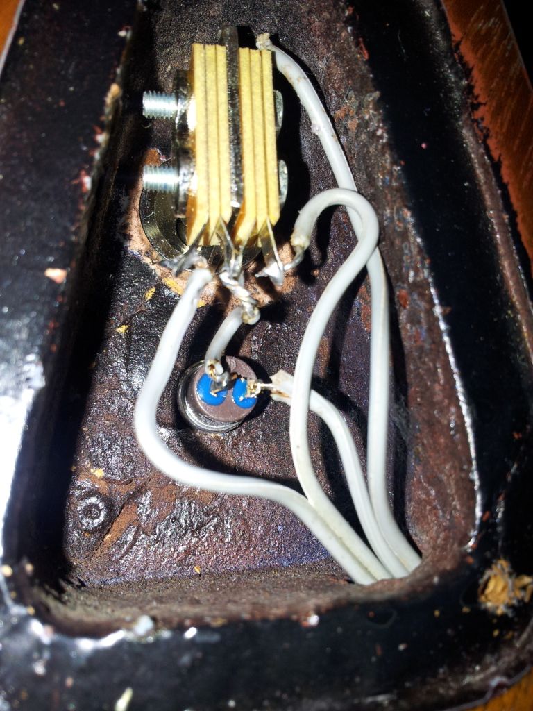

Ok so I see some bad things immediately. I made sure not to touch a thing so you guys can point everything out. First off.. it appears I used some type of old speaker wire or something to run to the toggle. I don't know how big of an issue that might be causing. I really can't re-do that. I had to drill holes through the body to basically re-route it to allow me to run wires through.. and its very tight and very difficult. I hope I can avoid re-doing that. Also the coil split wires the tape came off/exposed, that could be an issue.
Please point out anything you can. Like I said.. its actually dead quite at regular volumes. I never knew there was an issue til I cranked it to band level. And its not a feedback, it's crazy robot noises

PostPosted: Sat Dec 08, 2012 6:55 pm Reply with quoteBack to top
It's the grey unsheilded speaker wire. It's acting like an antanna. Get the vintage wire I mentioned. It's small enough that you won't need to redrill. Pm your email address and I'll send before and after pics of my TCMl for reference.

PostPosted: Sat Dec 08, 2012 8:01 pm Reply with quoteBack to top
Shielding the cavities might decrease it but it's not the best way. You'll still pick up radio interference along every one of those wires outside the cavities. For example, the long run to the selector switch. You'd be hard pressed to shield inside those drilled holes and runs.

PostPosted: Sat Dec 08, 2012 8:26 pm Reply with quoteBack to top
To be honest I could rewire that whole guitar with the braided wire a lot faster than I could shield paint it or copper tape it. I don't recommend sheilding the cavity.
